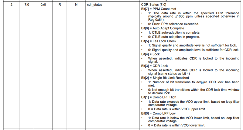

I'm trying to troubleshoot a confusing CDR lock inconsistency and I read in another thread "DS250DF230: CDR lock is not stable" that the bits in these registers can provide more information about what might be preventing lock.
Is there a document that describes the function of this and other registers/bits that are not described in detail in the Datasheet and programming guides?
Dave
  • Hi Dave,
    Please use the description from DS110DF410 data sheet.  This is valid while 0x0C[7:4] = 0.
    If you'd like additional assistance trouble shooting this CDR lock issue, please share a block diagram and details about your test setup and device configuration.
