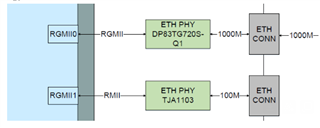

In our A sample board, after we reset phy and then read register 0x45d, the value is 0xd1a0, but in B sample board,the value is 0xffff.
A sample:
B sample:
Our soc is SA8295, the register log is
  • The register log for A sample and B sample is as follow.
  • The dp83tg720s in A sample board is ok, but in B sample it didn't work.
  • the partial log is:

  • Hi Hui,
    I don't see any differences in the A sample and B sample boards from your block diagram. Is there any difference in the hardware or software?
    Can you confirm you are using the Linux driver provided here? https://github.com/TexasInstruments/ti-ethernet-software/tree/main
    If not, please use the one provided at the link.
    Issues with register access can be caused by multiple HW or SW issues. If the new driver does not work, we can try to confirm the HW is working by
    (1) Measuring CLK_OUT on scope
    (2) Measuring INH on multimeter
    (3) Checking power up sequence
    Melissa
  • Hi Melissa,
    The driver runs on the qnx system, and the dp83tg720 driver code is the same, i have uploaded the driver code and block diagram of A sample and B sample.
    please help me check it, thanks.

  • Hi Hui,
    Since you are using the same driver code between the two samples, it might be an issue with the HW. Thank you for providing these measurements. Could you circle the schematic differences between A sample or B sample? The text in the photo is hard to read.
    Looking at your CLK_OUT signal, it looks like the scale is set to 50 miliseconds/square, so the frequency is around ~20 Hz, is this correct? The frequency should be 25 MHz.
    Melissa
  • hi, Melissa
    We have fixed this issue, thanks for your support.
  • Hi Hui,
    Thanks for the update. What was the fix?
    Melissa
  • hi, Melissa
    The phy addr is wrong, so we read the value of 0xffff.
  • Hi Hui,
    Thanks for updating. I will close this thread now.
    Melissa
