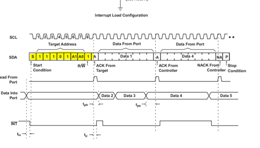

We found the datasheet and found that Figures 7-1 to 7-3 are shown on pages 11 to 13, and different drawings of Figures 7-1 to 7-3 are shown on pages 15 to 17 with the same figure numbers. On page 12, the target address is listed as (S 1 1 1 0 1 A1 A0),
We don't think this is correct info.

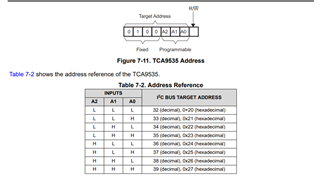

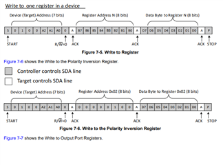

but this value is listed only on this page. On the other hand, on pages 14 and after, the target address is listed as (S 0 1 0 0 A2 A1 A0) in several places.
We think this below is correct/
Based on the above, we believe that the pages 11 to 13 are incorrect, and that the target address on pages 14 and after (S 0 1 0 0 A2 A1 A0) is correct, isn't it?
If so,
Can you fix this?
