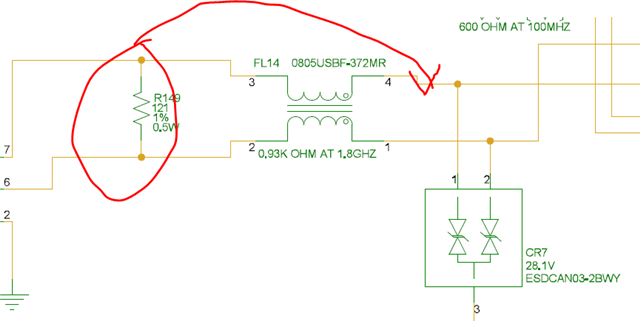

Hi Team,
I have drafted the schematics for TCAN1057AVDRQ1 may I request your review comments. The processor CAN0_TX & RX signals are 1.8V complaint as I understand the TCAN1057 does not require level shifter.
Please suggest.
May I request to have check point on the usage of CMC 0805USBF and ESD diodes.
Enclosed the schematics for your review
PrabhuCAN_Review_20240828.pdf
  • Hi Prabhu,
    I recommend put termination to the bus side of common mode choke, so CMC is placed between IC and the termination for the best filtering performance. And ensure TVS diode is placed close to connector when making layout.
