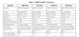

  • Hi Miyajima-San,
    When using an oscilloscope, our measurements are based on the amplitude of the eye. To get the amplitude we would measure the distance between the peaks of the histogram.
    However, for the recent datasheet validation of our SDI parts we used a Phabrix video analyzer for amplitude measurements. See the image below from Phabrix that shows the amplitude on the bottom left.:
    The maxhold measurement is still relevant and is present in overshoot and undershoot specs. See the table below for more SMPTE specifications, specifically overshoot and undershoot.
    Nick

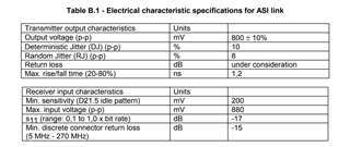

  • Thank you for your reply.
    I understand that the specifications in the datasheet are amplitude, not maxhold.
    Sorry to ask about the details."
    It says "Supports DVB-ASI at 270Mbps", but the DVB-ASI standard(EN 50083-9:2002) says the "OutPut Voltage" is 880mV (p-p), so there seems to be no regulations such as overshoot or undershoot.
    This device supports DVB-ASI, but strictly speaking, I understand that overshoot and undershoot are not taken into account in terms of DC specs.
    Is this correct?
    I apologize if my understanding is incorrect.
    Miyajima
  • Hi Miyajima-San,
    Thank you for sharing this document.
    I'm sorry, can you re-iterate this question? I am a bit confused by what you mean by DC specs.
    I sourced this definition of overshoot from tek for our reference:
    "Overshoot within the eye display is likely due to reflection along the signal path and can be due to incorrect terminations. The user will have to test the signal at various points in the chain to determine from where the reflections are occurring, this could occur at a patch panel, barrel connector or problem with a cable or connections."
    Nick
  • Hello Nick
    Sorry for the confusing question.
    According to our current output measurement results of this device, the maxhold is over 880mV, and the amplitude is within 880mV.
    Therefore, according to EN 50083-9:2002, the input specifications for DVB-ASI are stated to be within 880mV.
    I guess that the specifications of this device are 750-850mV at amplitude, which exceeds ASI's input specifications at maxhold.
    Strictly speaking, you can see that the flat areas above and below the swing voltage are mixed with noise from our measurement results.
    When measured with maxhold, it may exceed 880mV due to noise.
    Therefore, if you are considering this device based on overshoot and undershoot(10%=80mV), it is possible to output up to min=640mV and max=960mV, which would exceed ASI's input specifications.
    According to ASI's specifications, if the amplitude is 800mV+-10%, there is no problem, but since I have not found any such issue, I am thinking that the measurement should be performed at maxhold.
    What is the basis for your support for DVB-ASI?
    If you only consider the numbers, I feel that it exceeds the DVB-ASI specifications.
    You think that the input specs for DVB-ASI should be within 880mV for amplitude, so does this device support DVB-ASI?
    Miyajima

  • Hello Nick,
    Is there somewhere that the input standard for DVB-ASI is written as 800mV+-10% in amplitude instead of maxhold?
    I would like to know the evidence that there is no problem in making judgments based on the amplitude measurement results.
    My measurements show no overshoot or undershoot.
    However, as I said in the previous thread, it is noisy in the flat part and exceeds 880mV at maxhold, so I wanted to know the premise of the specifications of this device.
    I understand the premise because I heard it in a previous thread.
    Miyajima
