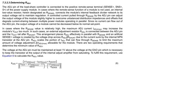

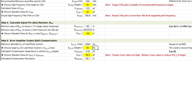

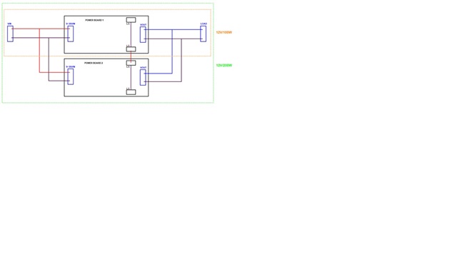

Hi
Could you help confirm whether UC3902 can be used in the following applications
Main design
Use three 12V@8.4A DC/DC and use load share controller to create a 300W power board
