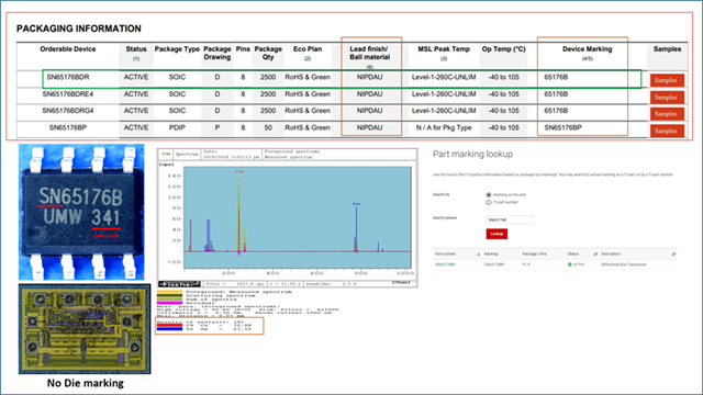

 We have observed some deviation between the actual parts and the TI datasheet that we need you help to clarify
  • Top marking per datasheet “65176B”, Actual “SN65176B”
  • Plating material per datasheet “NIPDAU = G4”, Actual “SN=G3”
  • Date code typical TI “YM”, Actual “YWW”
  • Missing TI Logo on top marking
