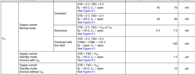

When the VCC (5V) consumes 20mA during CAN communication, for example, if the CANH or CANL signal gets a ground fault or sky fault, will the VCC (5V) current be 20mA+ IOS(SS_DOM) (Max.115mA)=Max.135mA? Or is it clamped to just 115mA by IOS(SS_DOM)?
