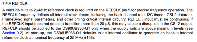

Hi Team,
I would like to check if there is a scenario that our crystal can't output REFCLK to 936 well. Do we see the black screen or the 935/936 would switch to internal CLK to generate the PCLK?
Roy

  • Hi Roy,
    The UB936 will have an internal clock that is used when the REFCLK is not present. This is not intended to be used during operation as the frequency will have a deviation of +/-10%.
    Zoe

  • Hi Roy,
    What do you mean by 936 can't work in this context? AON clock stands for always on clock. The AON clock is not intended to be used for lock between the 935/936 during operation. It is intended to be used so that registers can still be accessed and written while REFCLK is not detected present at start-up. A REFCLK is required for operation.

  • Hi Roy,
    For the first phenomenon, we would expect to see this behavior. If the REFCLK input is stopped, the devices will transition to the always on clock. The clock is not intended to be used for operation due to the potential instability on the FPD-Link operation that was observed. The AON clock will have a variation of 25MHz +/- 10% and each device will not have the same performance when REFCLK is lost. The internal clock can be used to access the deserializer however, it should not be intended to be used for normal operation.
    When the bit '1' was set, video data was lost as the REFCLK is forced to be found present.
