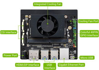

  • We were having stability issues with capture on our setup that uses ub960 as deserializer and ub953 as serializers on a custom platform. We are trying to do some platform independent testing with an NVIDIA devkit instead of our custom hardware to try and pinpoint what is causing the huge number of CRC errors and constant channel unlocks that we are getting. Our idea is to ideally use the ub960 EVM, with the Xavier NX devkit, but said evm uses Mipi-60 as the csi-2 outputs. And the devkit uses ribbons as the csi-2 inputs, see image below. We wanted to check if there is any other evaluation kit or adapter that can meet our needs to have ribbons as the NVIDIA Xavier NX devkit uses. Is there an adapter or another evaluation kit that uses the UB960, that is compatible with NVIDIA's Jetson Xavier NX devkit?

    Unfortunately, we do not have different evaluation kits for the UB960. To use the CSI-2 connector here, an adapter card would be needed for a QTH to FFC connector on the DevKit.
