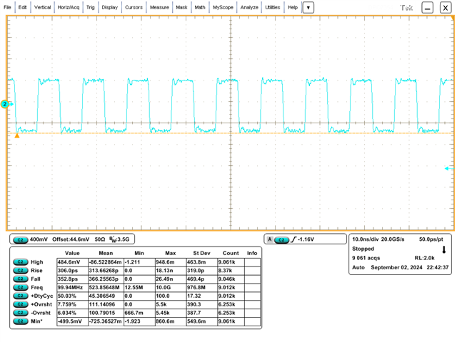

we have used the chip XIO3130 in our design. The PCIe_UP_CLKP/N is 100MHz,and PCIe_UP_Nreset is high in noral operation.we also captured those two signals with oscillograph. And we also captured PCIe_UP_TXP/N(it should be RXP/N for XIO3130, and TXP/N for SoC from xilix ) waveform with oscillograph, but we can't detect the PCIe_UP_RXP/N(it should be TXP/N for XIO3130, and RXP/N for SoC from xilix ).The below pictures are the CLK signal and PCIe_UP_TXP/N sigal waveformes. We set the PCIe_UP_CLKP/N PCB trace impedence to 100Ω,PCIe_UP_TXP/N and PCIe_UP_RXP/N is 85Ω. but why XIO3130 don't send the PCIe data signals? The below also includes the schemeatic.
The below is the CLK /TX waveformes and the schematic.
CLK waveform
TX signal
Can you help look into this case? Thanks!

    Thanks for your response. The XIO3130 chip is used in our old module, and we use the same schematic circuit to layout in our another product upgrade project. But it seems that it doesn't work. i have double checked the XIO3130 Implementation Guide document and also checked the power on sequence and power on timming of this new layout board with XIO3130 chip. The same result, upstream reset/clock/tx are all ok,but there is no signal in the rx.
    Can you give us some comments about this debug issue?it is weird.
  • Hi Abby,
    Could you please attach a scope capture of the signal observed on the device's TX / SoC RX (PCIe_UP_RXP/N)?
    Additionally, could you please also:
    • Specify if you are programming the device via external EEPROM, or if any configuration is being performed via serial bus?
    • Confirm if this issue is seen on multiple boards, or just one board?
    David
