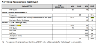

Hello experts,
Please allow me to confirm the XTAL requirements for use with DP83TC813RRRHFRQ1.
The following is an excerpt from the data sheet.
The data sheet states that the allowable frequency for XTAL is 25MHz+/-100ppm, is this correct?
We are planning to use the RGMII I/F.
I was curious because many devices require a 50ppm range when using RGMII.
BR,
