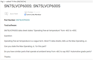

Part Number: SN75LVCP600S
See above image. I asked this question back in 08/28/24 - have not heard from TI yet.

Hi Buck,
I've looked around and haven't been able to find a part that shows max operating junction temperature for SATA3 application. I am assuming this is why you had considered this part. Please confirm SATA3 is the end application.
Regards, Nasser

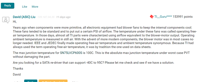

This was my answer posted to your original e2e thread question, are you not able to see it?
David
Hello Davis,
Yes, I did not see that response from your team. Thanks for your response. Yes we are looking for a part from -40C to 95C and above if possible.
Buck Patel
Buck
I can't find a part that can support temperature from -40C to 95C. We have SATA re-driver that can only support -40C to 85C.
David
