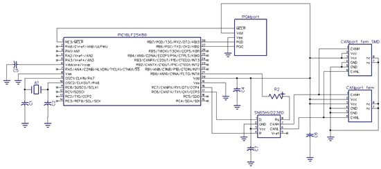

I'm using SN65HVD230 CAN transceivers to form a network of sensors. I'm using a baud rate of 100kz and a resistor (R2)
of 50kohm is connected to Rs pin to ensure that transmission will suffer low level of noises. The system works
well for a few days but fail randomly after that and I measure a resistance of a few kilo ohms between Vdd and
CANH (the same measurement read infinite at the beginning of the experiment). If I disconnect power for enough
time everything works again for a few days.
 - my network consists of 16 nodes only
 - each SN65HVD230 is powered (between 3.0 and 3.3V) continuously (I do not use standby mode)
 - I use 6 core flat modular telephone cable for the network (CANH, Vdd, Vdd, Vss, Vss, CANL)
(http://www.altronics.com.au/index.asp?area=item&id=W2313)
 - when not transmitting (recessive) the microchip microcontroller drive D pin high ("CANTX pin will drive VDD
when recessive")
Any help will be greatly appreciated,
Jerome
  • The schematics and idea's seem okay.  Have you checked that there are no transients or shorts on the bus that might be causing the devices to use the current limiters and also would raise the die temperature thus going into thermal shut down?   Do you have scope plots of the data to ensure there isn't anything un-expected actually going on the bus, ie before and after would be helpful.  Have you changed the CAN transceiver out to see if you may have damaged the unit?  How are you making this measurement between Vcc and CANH? You mention 16 nodes, are they all the same?  How is the network terminated since the cabling in use appears to not have a controlled impedance?  Have you checked for issues with the wiring where shorts could occur?
    These are a few steps to start debugging.
    -- Scott
  • Jerome, the schemtics do not show any termination resistors accross CANH and CANL.
    A CAN network may work on a lab bench without termination, (short cables) but it really needs a resistive connection between CANH and CANL to operate all the time.
  • Sorry, the schematics only show one node with two can ports to enable a daisy chain between node. The network in the field has termination resistors.
  • Thanks for your answer,
    I checked the network after installation before powering the system and there was apparently no shorts. When I do the same measurement after trouble, power removed, multimeter between Vcc and CANH, that's when I find the few kilo ohms resistance. Unfortunately I do not have the capacity to monitor the network in the field.
    The network is composed of 16 identical nodes. Each node has two can ports. they are connected in a daisy chain with termination at the end.
    The problem is recurrent. I tried already 4 times with the same components and every time it stops working after half, one or two days.
    In the datasheet page 6, the maximum rating output current is +-11mA, yet the normal operating condition low level output current is 48 mA. What happen if one of the transceiver stays in dominant mode?

  • Most CAN transceivers have a time-out to prevent staying in dominant mode, and will turn off when they overheat.
    Is there any transient protection, (i.e. transzorb) between the CAN transceiver and the network?
    Although most CAN transceivers have some on-chip ESD and overvoltage protection, this is typically not enough in most non-automotive installations.
    Not sure the exact CAN transceiver you are using, but typically they can handle at least -27 to +40V Bus Fault, and +/-200V Bus transient on the CAN data signals, so adding transzorbs to clamp CAN data signals within these usually fixes CAN transceiver failures in the field.
