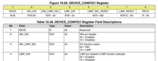

1. How should we set DEVICE_CONFIG1 register when we want to use LIMP function? There are INH_DIS, INH_LIMP_SEL, LIMP_DIS registers.
What happens in the conditions below?
a. INH_DIS=0(INH enable), INH_LIMP_SEL=1(LIMP), LIMP_DIS=0(LIMP enable)
b. INH_DIS=0(INH enable), INH_LIMP_SEL=1(LIMP), LIMP_DIS=1(LIMP disable)
2. When we set the INH/LIMP pin as LIMP pin, how does the pin behave in a watchdog timeout with WD_ACT=00b(Turns off INH for 300 ms and sets WD interrupt)?
Does the limp pin become High-Z state for 300ms and after that limp pin becomes high as described in 10.4.7.7 of the datasheet?

    1a) This means that the INH pin will be used as LIMP and LIMP function is enabled at that time.
    1b) This means that the INH pin will be used as LIMP and LIMP function is disabled at that time.
    2) No, this means that the INH/LIMP pin will only work as LIMP given the conditions that enable LIMP explained in the state diagram and LIMP section of the datasheet.
