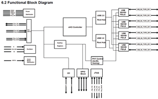

If 4 USB2.0 cameras are connected to 4 x USB ports converted from TUSB7340 PCIe to USB bridge,
Will each USB2.0 have 480 Mbps? Or 4 USB2.0 devices equally share the 480 Mbps bandwidth?

HI Kevin:
USB Streaming of audio and video normally uses isochronous transfers – these are packet based periodic transfers that are initiated by the host which have fixed but guaranteed bandwidth. Host controllers guarantee this bandwidth by planning a schedule of transfers ahead of time to ensure there is enough time reserved on the bus.
Normally USB2 bus supports 384 Mbps of isochronous (80% of 480 Mbps) bandwidth, 4 USB2.0 devices equally share the 384Mbps bandwidth.. You may need to check what is bandwidth for each camera used before using all 4 cameras.
Brian
Hi Brian,
When two USB 3.0 Cameras + two USB 2.0 Cameras are connected to the 4 USB ports of the Bridge,
The reference block diagram will be the bandwidth of two USB 3.0 Camera Share USB 3.0 HUB.
And is the bandwidth of the two USB 2.0 Camera Share USB 2.0 HUB being correct?
Kevin:
this is correct.
