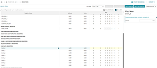

Procedure and issues:

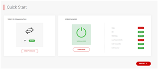

Power on 5V USB and GUI shows that a TCAN1145-Q1 device is connected.
Press clear interrupt and start device
This step sometimes the device goes immediately to sleep mode and cannot be woken to standby or quickly switch to standby/normal then sleep immediately. Do you know what could be the cause here?
When in normal mode and not connected to any other CAN device via DSUB9, Voltage measure on CANH can CANL to GND are 0V, which is not 2.5V as expected?
When TXD wave signals is applied to the transceiver, there is no reaction on the bus and also RXD pin.
All SPI commands are still able to be read or written to the transceiver but after sometimes actively working on the GUI SPI will be in inactive state (even auto read every 1 second is turned on).
Could you please check the setup to see if it is sufficient or not? And also is the behavior of the chip expected or not?
    This device has a sleep wake error (SWE) timer that is used to place the transceiver into sleep mode if a long period of inactivity (~4 minutes) is detected. Please ensure you are switching the device into normal mode within 4 minutes of initial power on of Vsup.
    This EVM does not have a CAN controller included on it, so another device will need to be connected to the TXD and RXD pins of the transceiver in order connect to other CAN nodes and drive CAN data. When in normal mode, the CAN bus should be biased to 2.5V. This bias may be turned off in other modes if the CAN bus is idle. Please ensure the transceiver is in the correct mode. Keep in mind the SWE timer. I recommend periodically clearing the device interrupts in order to prevent an automatic timeout into sleep mode.
