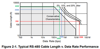

There exists a tradeoff between speed and maximum bus length.
If 5% jitter is acceptable, is my understanding correct that this device supports the following specs?
Max cable length is 200ft(60m) at 20Mbps.
Max cable length is 2000ft(600m) at 500kbps.
Max cable length is 4000ft(1200m) at 300kbps
Section 2.2.3 says that “further complicate the trade-off is the question of network topology”.
This product supports 256 nodes.
Are the above three specs of data rate vs. cable length met at 256 nodes?
  • Typical RS-485 buses support these specs (regardless of what transceivers you are using).
    These values are specified for the maximul load, i.e., 256 nodes. But the remark about network topology does not talk about the number of nodes; it says that if you have stubs, then the jitter becomes worse.
  • Max cable length is 200ft(60m) at 20Mbps.
    The scaling on this graph is actual logarithmic so I think some of the values you highlighted are slightly off. (Your drawings assume linear)
    300kbps is 4000ft (1.2km)
    500kbps is ~2500ft (760km)
    20Mbps is around 200ft (60km)
    No.
    I believe this graph comes from the RS422 standard (not 100% sure) but I assume that the graph uses the assumption that the bus is terminated and there are no additional nodes on the bus. With additional loading and stubs or bad design practices you may end up getting less distance. If you used a cable without impedance controlled wires then this distance wouldn't be possible. Or if you have a bunch of parallel lines/stubs on the bus then this would shorten the distance (like if you used a star network or a ring network). The best way to achieve this distance with the speed is to use a daisy chain and properly terminated lines with impedance controlled cables.
