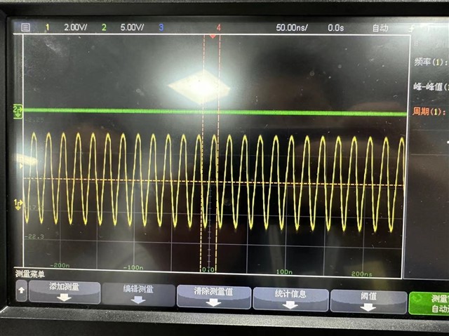

Could you please help review if the waveform of CLKOUT pin is OK?

I cannot tell from this picture alone. Please share the frequency measurement (>3 decimal places) and amplitude measurement of the CLKOUT signal.
