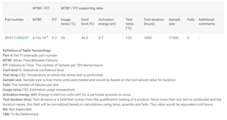

Kindly give the grade details(automotive/Industrial/commercial), EOL , FIT Rate with respect to CL=95% , Temp=55 deg C for the above mentioned part number.
The information available on this can be found in the following links:
Quality, reliability, and packaging data download | TI.com
TI currently has no plans to EOL the ADS1115. Before any EOL occurs, a device will enter a state of NRND (not recommended for new designs) then Lifetime/Last time buy, then EOL. We have no plans to make the device NRND.
