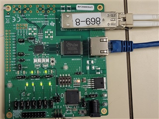

Configuration:
- PHY on 1000BaseX to 1000BaseT conversion.
- Bootstraps: Auto-negotiation ON, 1000 Mbps, full Duplex on both sides of link 1000BaseX.

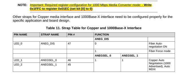

- Perform PHY register configuration sequence for 1000 Media mode converter (usb-2-mdio).
- 1000BASE-T of evaluation board connected to Gbit Switch. Computer, with 1000BaseT Card, also connected to this switch with address on same network.
- SW[4:1] = 0000 Normal operation.
What we observed?
- No errors are detected in the registers associated with the PHY. Led LD2, LD4 lights up solid green and LD6 flashes green.
-State 1000BaseX link: Auto-negotiation Complete, No Link Error. Seems there are Traffic: No always Rudi(/I) (idle) when make a ping.
-D1 Led (P1.0 y P1.1) lights is up (orange)

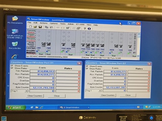

- We execute a ping from both sides of the network and no type of traffic is detected, with a wire-shark type analyzer
