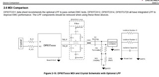

DP83TC812R-Q1: Output LPF
Part Number: DP83TC812R-Q1
Other Parts Discussed in Thread: DP83TC811
 In the previous DP83TC811 design, an LPF was added to the output to improve EMC performance. If the design is directly upgraded to DP83TC812, how should the LPF be handled? Is it appropriate to short it directly?
