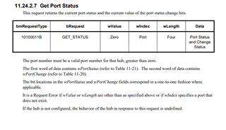

My customer is using the TUSB4020BIPHP device and needs the ability to reset each port individually. They believe that the batEN bits in the Battery Charging Support Register can enable them to do this. The catch is they need to be able to do the resetting through a USB command to this device via Windows. Can we help explain to them how to enable this? Not sure if we have windows drivers that would include this, or guidance on how to do it themselves.

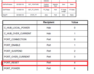

  • Hi John:
         Battery enable has nothing to do with port reset.
         you can use SETPORTFEATURE command and Feature selector is 4 for Port_reset
    Best
    brian

  • John:
        All above information is on USB 2.0 spec section 11.24.2.7 , or they can search SetPortFeature(PORT_RESET)  from the spec.
    Best
    Brian
