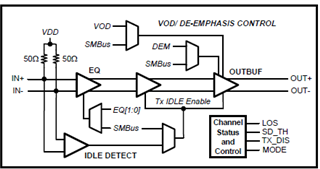

Hi TI engineers,
Please provide a detailed block diagram of the DS64BR111. It is more detailed than the block diagram below.
Especially, We would like to get an equivalent circuit of the "Outbuf".

Greetings,
To get a more detailed operation of the either input or output, suggestion is to use IBIS-AMI model of DS64BR111 for signal integrity simulation and analyses. Please follow the link below:
https://www.ti.com/lit/pdf/snlm143
Regards,, Nasser

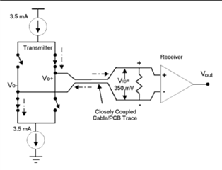

Hi Nasser,
Thank you for replying.
I'd like to know equivalent circuit of "Outbuf". But I don't understand an "IBIS model".
Now I'm understanding an equivalent circuit of "Outbuf" below.
Is it correct?

Greetings,
IBIS-AMI model not only provides output structure but all the way from input to the output. Therefor it would be best to use IBIS-AMI model of the part. With respect to output buffer yes it is similar to LVDS type like what you have shown above.
