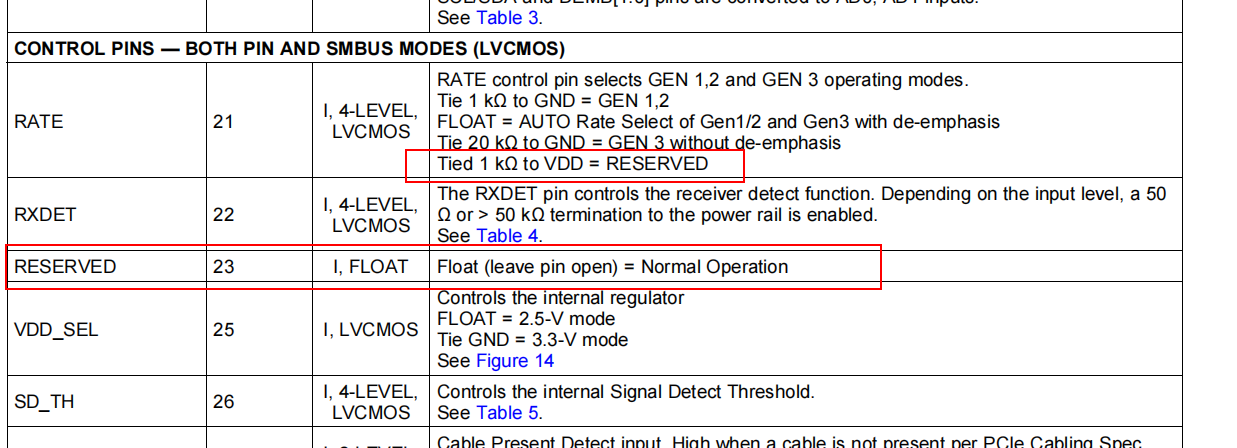

    Another question, what does the Normal Operation on the RESERVED pin mean?
    I understand, DPHY440SS supports a max data rate of 1.5 Gbps per channel so I cannot be used for your application. I'm checking with a CSI-2 expert on my team if anything else needs to be considered to use DS80PCI800 with CSI-2. I'll follow up when I have more feedback.
    TI marks pins or settings as "Reserved" when the functionality is kept internal. Pin 23 needs to be left floating for the redriver to operate correctly. Pin 21 should not be pulled to VDD because this is not a valid RATE setting.
