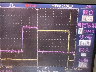

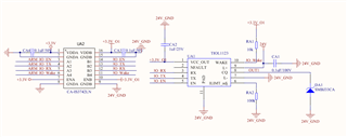

    We use TIOL1123 as output,  output mode is NPN,
circuit is shown as below:

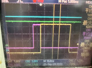

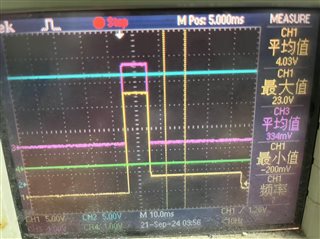

When EN is high, CQ is normal, 0V. When EN is low,  CQ is about 4V at the beginning and then turn into 0V after about 40ms.
Purple is EN, Yellow is CQ.
SO why output is abnormal when TIOL1123 become Hi-Z status?
