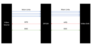

    In a DDC implementation as follows, the DDC would not be able to communicate:

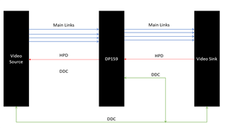

    If you are using the DP159 in snoop mode, then DDC would be communicating regardless of the status of the DP159.

    Q1
    The customer says that he doesn't quite understand the diagram below.
    Which part of the diagram below is the problem (reason) that prevents communication?

    The DDC communication is a link negotiation bus between the source and the sink. This is where information like the resolution, refresh rate, and link rates are set.
    There are two ways to set up the DDC of the DP159 in an HDMI application:
    1) The DDC goes through the DP159 (DDC is in series through the DP159). In this case of the DP159 is powered off, then the DDC will not be able to communicate:
    2) The DDC is routed around the DP159, and the device is used in snoop mode. (DDC is in parallel with the DP159)In this case if the DP159 is powered off, the DDC will still be able to communicate:

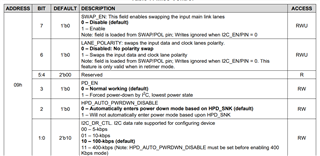

  • Hey,
    Just finished testing. Its found that the TMDS_OE pin does not affect video output at all. Its best to use the PD_EN bit in register 0x09.
    When using this pin this powers down the DP159, but the I2C control lines remain active.
    If this device was displaying video before setting the PD_EN pin, then the source will keep DDC communication for ~10s after the PD_EN is set to 1. In that 10s window setting the PD_EN pin to 0 will resume video as normal.
    If PD_EN is not set to 0 before the 10s window then HPD must be toggled for video to resume.
  • We are using the HP ProDesk600 as the source for this behavior. This may vary based off of the source used.
