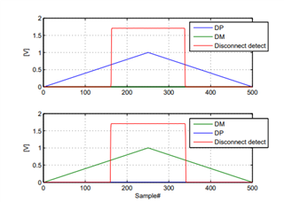

  • Hi Yoda:
    HS disconnection must be indicated when the amplitude of the differential signal at the downstream facing driver’s connector ≥ 625 mV, and it must not be indicated when the signal amplitude is ≤ 525 mV.
      for TI test setup: The voltage on DP is swept while DM is held at 0V then the voltage on DM is swept while DP is constant at 0V. Typical V-V plots are shown  below:

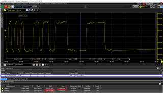

  • Hi Brian:
    Thank you for your reply.
    We tried increasing the amplitude value to check the disconnect detection, but the disconnect detection did not occur even when it exceeded 625mV.
    The waveform below is an example of the disconnect detection not being detected even when it exceeded 680mV.
    The USB2.0 standard states that disconnect detection occurs when it exceeds 625mV. (Red frame below)
    We would like to hear your opinions on the measurement method, location, timing, etc. carried out here.
    We are investigating the cause of the difference between the standard and the actual measurement.
    Measurement location: Measured near the B12 (USB_DP_DN2) and A13 (USB_DM_DN2) terminals of the TUSB7320 with a differential probe
    Measurement timing: Sampling between the Start Of Frame and the End Of Packet
    Yoda

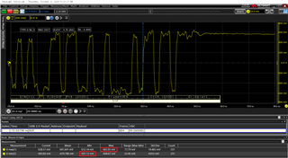

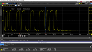

  • Hi Ryan
    These are the conditions for obtaining a waveform where the disconnect detection exceeds 625mV.
    - Connect to a USB memory (with built-in flash ROM).
    - Change the resistance between R1EXT (pin A24) and RIEXTRTN (pin B23) of the TUSB7320 to increase the voltage amplitude.
    - Waveform at the time of disconnection (cannot be recognized as a packet)
    - USB2.0 eye diagram

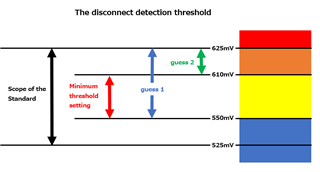

    I have summarized the answers I have received so far in a diagram.
    Which threshold range is guess 1 or guess 2?
    Ryan Kitto said
    -When we talked regarding the disconnect threshold/detection,
    we found that there is a setting for a disconnect threshold for each port, with the setting for the disconnect threshold being set to the max setting.
    -As far as I am aware, there are not TUSB7320 parts where the disconnect threshold should exceed 625mV.
    From these two sentences, does the maximum setting for the disconnect detection threshold be 625mV?
    If it is different, please comment.

  • Hi Yoda-san,
    I would say guess 2 is likely closer to the actual disconnect threshold, however, I would not say the minimum disconnect is at 610mV. It's likely less than that, within that 550-610mV range. As for the maximum, yes, that is likely 625mV.

  • Hi Ryan

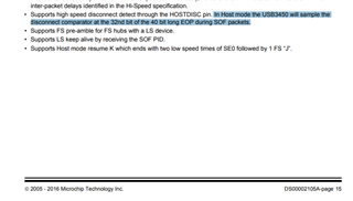

  • The time to detect a disconnect event is a minimum of 40 bits per USB spec.  The signal amplitude over the threshold itself may not trigger a disconnect.
  • Hi Undrea
    Under what conditions will a disconnect detection be triggered?
    Will it not be detected if the time exceeds the regulation for an instant at the [ns] level, as shown in the red circle below?
    Regard
    Yoda

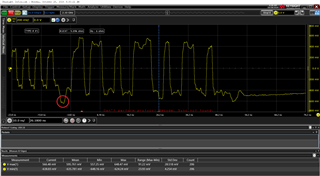

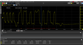

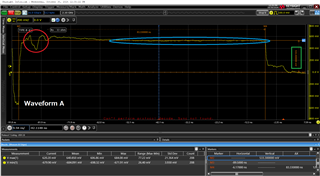

  • Hi Undrea

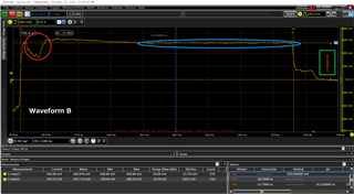

    I checked it further.
    Could you comment on the results?
    Measured at 40 bits of EOP (End of packet) in the USB specifications.
    Is the threshold for disconnect detection the peak of that section (40 bits) (red frame), or the gentle part (blue frame)?
    waveform A(Disconnect not detected)
    waveform B(Disconnect detected)
    Comparing the potential of the gentle part (blue frame) (green frame), waveform A does not detect disconnect at 533mV,
    but waveform B detects disconnect at 560mV.
    *A cursor is positioned at 40 bits (83.3[ns], which is 40 times 480MHz).
    Regard
    Yoda
  • I believe the voltage level is sampled at that specific time (After the ~40 bits), not the peak.

    This is an example from another company, but there are also cases where the judgment is based on specific bits.
    https://ww1.microchip.com/downloads/aemDocuments/documents/OTH/ProductDocuments/DataSheets/00002105A.pdf
    The following passage is found on page 15.
    "In Host mode the USB3450 will sample the disconnect comparator at the 32nd bit of the 40 bit long EOP during SOF packets."
    Is there similar information on the TUSB7320?
