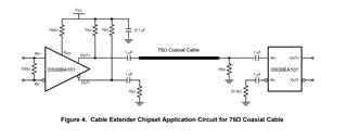

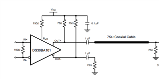

  • Naoki-san, a 50 ohm to 75 ohm impedance circuit is not recommended because it will cause reflections along the transmission line and compromise the signal integrity. For continued development we recommend using one of the two topologies:
    1) Using the DS30BA101 as a 50 ohm to 75 ohm conversion and DS30EA101 or LMH0324 as a redriver.
    2) Using 50 ohm impedance for the entire transmission.
    Nick

    1) I will try it. Could you sent the DS30BA101's IBIS-AMI model?
    2) I can not use 50 ohm impeadance for the entire transmission since in your products it seems that there is no simulation models of DS15EA101or DS30EA101, or other similer devices for 50Ω-cable. I have looked at other manufacturers products, but they do not provide simulation models for transmission so they are not my option for now.
    I would also appreciate it if you could tell me whether the frequency unit corrections in tx_term.s4p files are correct.

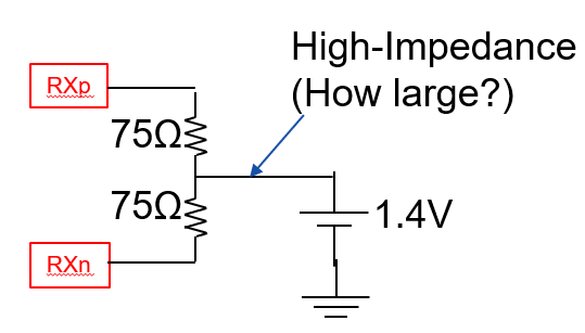

    Going back to the LMH0324, could you let me know a detail of the termination structure on receiver side? From the results of my simulation using LMH0324's IBIS-AMI and S-parameters, it looks like the 75 ohm is pulled down to GND, which divides the voltage and reduces the signal amplitude. Is the actual device terminated like that? If possible, I would appreciate it if you could explain the receiving termination structure using a diagram.
    Naoki
  • Hi Naoki,
    I asked the design team for a reference, and they informed me that the receiver is connected by a 75-Ω to 1.4V (internal common mode voltage). As the LMH0324 datasheet states for IN0+ and IN0-: "Single-ended complementary inputs, 75-Ω internal termination from IN0+ or IN0- to internal common mode voltage and return loss compensation network"
    Here is a very simple diagram that may help to illustrate the scenario. Note that this is something I made and is not directly representative of the actual device structure.
    Nick
  • Hi Nick,
    Thank you for creating an easily understandable diagram.
    Your diagram only shows the RXp port, but this device has differential inputs with both RXp and RXn and these are terminated to the internal common mode voltage of 1.4V. Is the following diagram correct as a more detailed representation of the termination structure? If my diagram is correct, could you please tell me approximately how large the resistance of the High-Impedance part is?
    Naoki
  • Hi Naoki,
    You're welcome. The diagram is correct except that there is not a high impedance portion.
    Nick

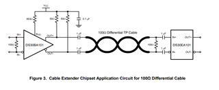

    2)As for DS15EA101, a recommended configuration for 100 ohm differential is shown in figure 3 on datasheet. though the 100 ohm is before AC coupling capacitors, Can I change the position of 100 ohm to after the capacitors? If there is some negative effect due to the change, please let me know.
    Naoki
    I want to advocate for placing the resistors before the capacitors for two reasons;
    1) Placing the capacitor as close as possible to the device will reduce the loop inductance created by the trace length between the capacitor and the signal pin. By placing the resistor second, you are using layout space that will augment this negative effect.
    2) I have a minor concern about the low frequency content looping around the high speed traces when the AC cap is not present to block that content.
    Nick
  • Hi Nick,
    In many cases, since small chip resistors are used, I think the trace length will be shorter. However, is the effect of loop inductance still significant? From the perspective of eliminating the effects of reflections, I thought that it would be better to place the termination resistor as close as possible to the input pin. Which is more important when compared to the effects of loop inductance?
    Since AC capacitors will be placed, it seems that we don't need to worry about the effects of low-frequency components.
    Naoki
  • Hi Naoki,
    I found a quote from a previous E2E that summarizes my point on AC caps:
    "AC cap, RX ESD structure, and connectors can all be seen as Discontinued Impedance Points along the PCB trace. If they are placed CLOSE ENOUGH, the Impedance  drop caused by AC cap(smaller) and RX ESD structure(larger) could be approximately seen as ONE Discontinued Impedance Point, so this is better for signal integrity. " -Quote
    I am not certain which is more impactful to signal integrity. I think I agree with you in saying that the resistor close to the pin will reduce reflections. Is it because you think the resistor will dissipate the reflected power?
    Nick
  • Hi Nick,
    Yes, I believe that even if reflections occur due to impedance discontinuities on the trace caused by AC cap and so on, the reflections will be dissipated at the input pin if there is a matching resistor. Furthermore, referring to the LMH0324, this device has a termination resistor internally, and an AC cap will be attached externally. This means that a termination resistor is placed after the AC cap.
    The configuration of placing a 100-ohm termination resistor before the AC cap is just one example, so is it also recommended to place a 100-ohm termination resistor after the AC cap?
    Naoki
  • Hi Naoki,
    That's a good point. My main objection to placing the resistor after the capacitor was because of the possibility of a increased trace length, however, after discussion with you I am convinced that it would not be a long enough trace to cause problems, and that our other devices like the LMH0324 have a similar RX ESD structure without issues.
    As long as the impedance drop by the RX ESD structure is close enough to be seen as one impedance point, it sounds good to me.
