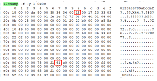

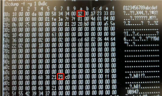

Sometimes, we can see a bug: soc can not receive any touch positions from display panel,
This is the NG i2cdump of 947:
This is the normal i2cdump of 947:
The values of  0x0a and 0xC7 are different.
And what is the meaning of 0xC7[6] : Interrupt on Receiver Detect interrupt: A downstream receiver has been detected?
Is it mark 947 has been received a interupt pass through 948?
Best Regard.
  • Hi Yao,
    0x0A is the 8 least significant bits of CRC errors on the back channel. Fluctuations between 12h and 13h is negligible and not a noteworthy difference. 0xC7[6] can be utilized as an interrupt that triggers when a downstream receiver has been detected.
