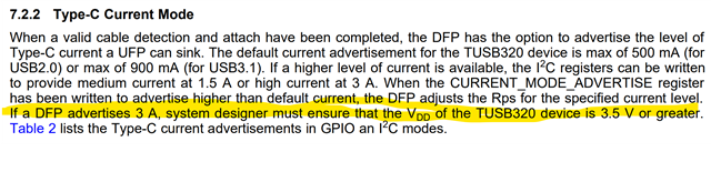

Hi TI team,
I've set TUSB320LAI to I2C mode. Enable 3A current output. It can now charge the phone, but not the 3A, and it doesn't charge the iPad.

Hi Pakho,
For TUSB320 device to advertise 3A, TUSB320 Vdd has to be 3.5V or greater. Assuming all steps to configure the CSR registers using the I2C mode is correct, it is likely that the device is not given the correct Vdd to advertise 3A based on the design you provided.
