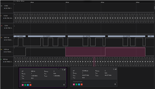

I'm having trouble sending I2S data, created by a Raspberry Pi, from DS90UB947 to DS90UB948. Ultimately, the data will be sent from the UB948 to a TLV320DAC3100, but at the moment, I'm just measuring at the Pins of the UB948. See below for the various connections.
My current problem is that only I2S_CLK seems to arrive at the UB948, I2S_WC and I2S_DA don't ever change when applying 44.1 kHz, 16 bit stereo signal to UB947 (CLK 1.5 MHz).

The Signal from the Raspberry:
I tried 44.1 kHz and 48 kHz, 16 bit PCM. I currently haven't managed to output any other frequencies - need to investigate first. But according to the UB947 data sheet, this should be allowed?
I know that the Raspberry cannot produce the exact frequencies, may this by a problem?
    The associated I2S CLK frequencies are 1.411 MHz and 1.536 MHz, respectively. Do you know how close the frequencies of the Raspberry Pi are to these values when 44.1 kHz and 48 kHz sample rates are selected?
