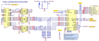

TUSB8043A: What are the correct connections when using with HD3SS3220 mux?
Part Number: TUSB8043A
Can you confirm that the SS TX and RX are connected correctly between TUSB8043A and HDSS3220 in circuit below.  Hi-speed portion of hub seems to be working but not Super-speed.
This seems a bit confusing to me from the mux EVM schematic.
