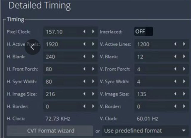

this is the panel timing:

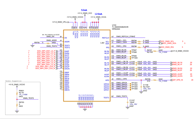

This is the hardware schematic:
