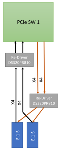

Hi David,
Do you have any information about what the max allowed length is? The placement is shown as below.
Hailiang
Hi Hailiang,
The allowed trace length will depend on the properties of the board material used in the design and the routing of the high speed channels in the system.
Are there any details regarding the proposed layout?
Additionally, this application note is helpful to understand layout recommendations for PCIe Gen5 applications: High-Speed PCB Layout for PCIe Gen 5
