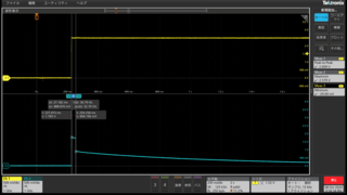

When power is applied to the Retimer, the waveforms of the Retimer's power supply (ch1) and 100nF-decoupled output signal(ch2) look like the attached file.
At this time, no input signal is applied to the Retimer and the output is open.
Please tell me why the Retimer output rises.

    I believe this is due to DC bias getting applied to DS250DF230 output when power is applied.
    Drew

  • Hi Takashi-san,
    Can you clarify some details on your measurement?  Are you measuring single-ended or differential?  Are you measuring 0V immediately after power up, or after some time?
    I'd have to double check the output impedance of the driver.  The driver is typically muted while the retimer does not have CDR lock.

  • Hi Drew-san,
    I measured the 100nF-decoupled output signal single-ended immediately after powering up and it measured 0V.

  • Hi Takashi-san,
    I observed similar behavior as your initial scope shot if the scope is configured with high impedance termination.
    If the scope channel is configured with 50 Ohm termination, the signal from the DS50DF230 on power up is much smaller.
