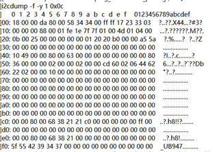

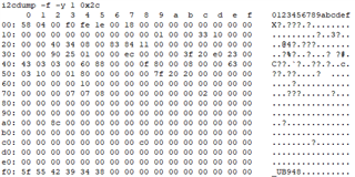

    These are the dump maps of 947 and 948, we sorry but did not probe the Lock pin of Des
    Best Regards.
  • Hi Yao,
    Thank you for sending these in. It looks like there are a few CRC errors on SER reg 0xA- 0xB, this could indicate SI issues.

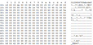

    2. Read SER 0xA - 0xB repeatedly, maybe every few seconds, and check whether it increases continuously.
    --->>>This Time, it is 0xff (see the below pic),

  • Hi Yao,
    1. The back channel CRC errors count indicates signal integrity issues. So this could be related to IL/RL not matching channel specification through the layout, parts selections, connector, cable, etc.
    2. Are all the necessary errata being applied for the 947? Could you please share the script?

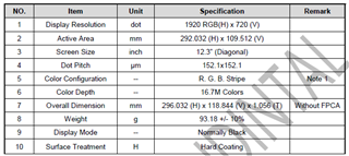

  • Hi Ikram,
    These are the spec which got from display panel  manufacturer。
    Best Regards.
  • Hi Yao,
    Thank you for sending these, and I will work on a PATGEN script for the 947 with these timings.
    Ikram

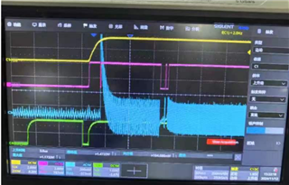

  • Hi Ikram,
    These are the startup waves of Ser and Des .
    Yellow: PDB of 948;
    Purple: Lock of 948;
    Bule: Pclk output form 948;
    Green: PDB of 947.
    So, whether the timing sequence isn't fixed, and 947's init is more early than 948?
    Best Regards.

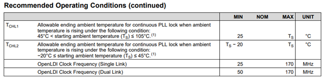

  • Hi Yao,
    Can you please check whether the power-up sequence follows the 947 datasheet? PDB should be high after there is stable OLDI clock input.
    Also, your PCLK rate (according to the display timings you shared) is 47.98 MHz.
    For 947, that rate (below 50 MHz) is only supported by Single-Link mode using only DOUT0. Could you change the MODE_SEL settings and cable connection so that it's in single-link mode?
    Ikram
  • Hi Ikram,
    Thank you very much, we had almost fixed this issue,but we still have one issue need you help:
    The display panel had been bulit before our Head Unit, and display panel had made a rule which 948 init by itself, 947 init by head unit.

  • Hi Ikram,

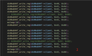

    1:We set the pclk to 50.5M;
    2:We mission Errata 3(below Pic), they only run one time before, now we set them retry 20 times;
    Display panel make a rule which 948 init by itself, but head unit need to write/read 0x68 and 0x69 of 948, maybe display panel are writing 948's other registers at this time.
    So we want to kown whether this action would broken the 948's initialization?
    Best Regards.

  • Hi Yao,
    The "Timing Confirmation" code should be run after there is LOCK, and stable video data being sent through. Is it possible to change the code so that the host SoC executes this code in sequence rather than the MCU on deserializer side? Is there a way you could verify whether the display I2C activity is occurring during this?
    Also, just for testing purposes, has there been stable video or while running this full script, does it always show error after running several times as you mentioned?
