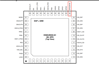

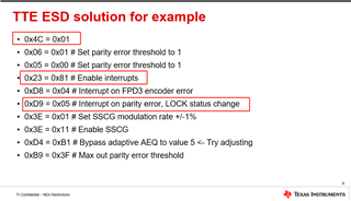

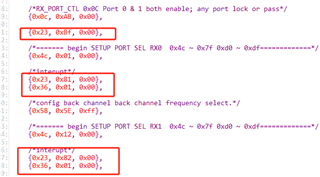

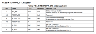

1: In the above picture, I set the above groups of registers according to the configuration, but manually disconnect the camera - analog disconnect lock link, GPIO_3 interrupt port does not change the level;
2: Set register 0x36, manually disconnect camera - analog disconnect mipi link,GPIO_3 interrupt port also has no level change;
Please help to analyze the reasons and give solutions;thank you so much~
