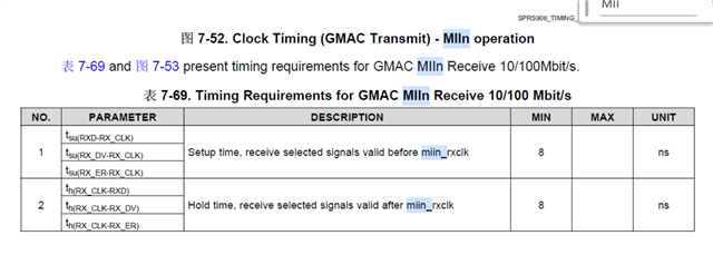

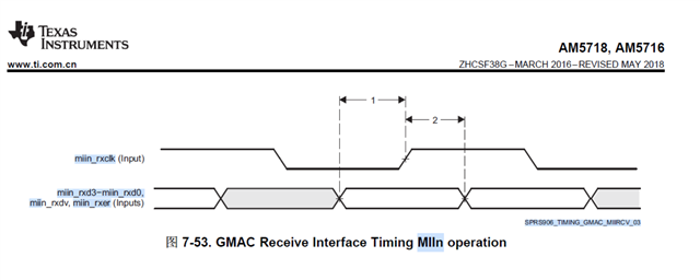

    We actually have a issue of timing about RX_CLK in MII mode as shown below. The AM5716 specification requires a minimum setup time and hold time of 8ns,It is obvious that 1.7ns does not meet the specification. So how to set  DP83822 to meet the specifications,  RX_CLK polarity reversal or clock shift ?

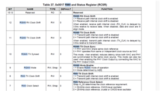

    The RX transfer rate can be increased to about 2.2MB/s after seting the RCSR(0x0017) bit 12 from 0 to 1,  waveform shows setup time is 4ns.
    Therefore, we highly suspect that the low speed is caused by the setup time not meeting the specifications. 4ns still does not meet the AM5716 specification, how to set setup time> 8ns.
  • Hi Alvaro,

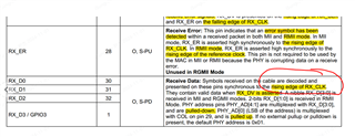

    Sorry, I have to correct the information.   We double checked the DP83822 Settings  and found that it was working in RGMII mode not MII mode.
    Data sampling reference clock falling edge if in RGMII mode,but pin function description section show the reference is clock rising edge. I'm confused,Could you give me some advice.

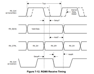

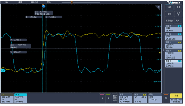

    If refer to the RX_CLK clock rise edge, the waveform shows that the worst setup time is 900ps<1ns (RGMII spec), and the best can be 1.7ns>1ns.I suspect that's the problem,So setting  RCSR register bit 12 from 0 to 1 can fixes the issue.
    But I'm not sure if the data refers to the rising or falling edge of the RX_CLK.

    Thank you for confirming. Does enabling the RGMII RX_CLK Shift (RCSR Reg 0x17[12]) solve your issue?
    In RGMII, the data is sample on the rising edge of the clock for 10/100Mbps speeds. At 1000Mbps, the clock is sampled at both the rising and falling edge.

    Yes,Enabling the RGMII RX_CLK Shift (RCSR Reg 0x17[12]) can solve our issue.Do you think the root cause is that RGMII RX_CLK Shift is not enabled? RGMII RX_CLK Shift should be enabled or disabled?

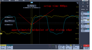

    When we use an oscilloscope to measure the setup time, the cursor should be aligned at 50% of the amplitude or the midpoint of the rising edge, right? We don't find an introduction in Std 802-3,If you have relevant introduction documents, could you email to me.My E-mail address is: yinjie1@sungrowpower.com

    Thanks again for confirming. Yes, RGMII RX_CLK Shift not being enabled is the root cause of this issue. Please keep it enabled. We want the clock to be slightly behind the data, so that when the rising edge of the clock comes, the data is sampled in the correct state.
    In the scope capture you shared, the blue signal is RX_CLK and the yellow signal is RX_CTRL correct? RX_CTRL is supposed to trigger on the rising edge of RX_CLK, seems like it is doing exactly that! Regardless, if communication is working with RX_CLK shift enabled, I wouldn't worry about the setup and hold times anymore.

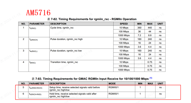

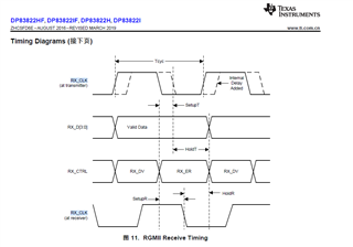

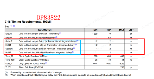

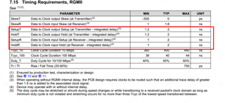

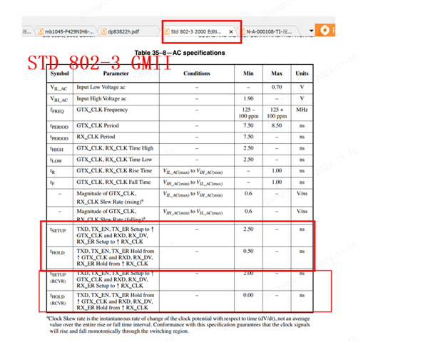

    One question for the DP83822 specification is "integrated delay" as shown in the blue box below.Does it refer to PHY internal delay or MAC internal delay?
    Another question is the difference between the AM5716 specification and the 802-3 standard.The 802-3 standard shows that the setup/hold time are 2ns/0ns, and the rise/fall time is 1ns/1ns. However, the AM5716 specification shows that the setup/hold time are 1ns/1ns, and the rise/fall time is 0.75ns/0.75ns.These differences confuse me. Could you give some comments.
    Note: The RGMII specification is not found in the 802-3 standard, I just refer to the GMII specification in  the 802-3 standard.
    This could refer to either, both the DP83822 or the MAC can introduce delay. I have seen that several TI processors have a default delay on TX_CLK that cannot be disabled, so the TX_CLK delay on the DP83822 should be disabled (Reg 0x17[11] = '0') and the RX_CLK delay should be enabled (Reg 0x17[12] = '1').
    Spec comparison can often cause confusion and the GMII spec is not apples-to-apples. Please find the RGMII spec below. The data to clock delay is referred to as Tskew in the standard.

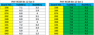

  • Hi Alvaro,
    Yes,The current issue is resolved.Below are the test results of 10pcs board.
    First, The Rx rate can reach 4.2MB/s,That's OK;
    Second, Please pay attention to the Tx speed.The rate of Tx also increases a bit (about 7MB/s->8MB/s) when RCSR Reg 0x17[12] is set to 1.
    It's so confusing that RCSR Reg 0x17[12] affects Tx rate .Could you give some comments.
