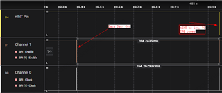

I want to configure the Transimission Complete Interrupt to nINT pin, and when data is sent out, I can get the TC Interrupt notification from nINT's IRQ_Handler.
2. What is My Question?
1)  I use following code  (disable WDT, enable TC & RF0N  irq) to initize the tcan4550-q1, and configures IRQ linked to nINT pin
2)  Then using SPI to send data out.
3)  When SPI calling is over, it takes about 760ms +  for the nINT pin to become low  from high (which indicates the Transimmision Complete Interrupt happening)
My Question :
the TC interrupt waits too long  to happen after sending data out, it should not be 760ms +,  what is the root cause ? please help me to check the configurations. thank you so much ...
following figure shows the big delay

  • Hello Nix,
    It is not clear from your logic analyzer plot when the CAN message actually completed the transmission.  It shows the time between when the message buffer was enabled for transmission and when the transmission complete interrupt occurred, but it does not actually shown when the message transmitted.
    Sometimes a message can't be transmitted immediately due to the CAN Protocol and the rules of arbitration.  I don't know what your CAN bus traffic looks like, or whether there are any additional CAN messages that could cause an arbitration delay to the message transmission.
    I would suggest you try to monitor the CAN bus and determine the time from the End of the CAN Message transmission and the time of the Interrupt?
    The TCAN4550-Q1 uses the MCAN IP developed by Bosch for the CAN FD Controller.  More information about this IP and the TX Handling can be found in section 3.5 of the M_CAN User's Manual (Link).
    Jonathan
  • Hi, Jonathan,
    thank you for your support.
    following figure shows the time when Data sent from CAN, it's very closed to SPI timing . and about 760ms later, the TC Interrupt happens
    And in addition, the big delay for TC interrupt  happens in every data transimission .
    is there any way to commit the transimission  and interrupt  immediately
  • Hi, Jonathan,
    i found the root cause that i configured the ILE register to wrong value.
    thank you
  • Hi Nix,
    I'm glad you found the root cause and thanks for letting me know.
    Jonathan
