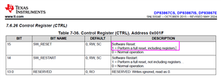

    We added some debug messages in the dp83867 driver to read the LED register values upon entering the driver’s init function, "dp83867_of_init." The values matched those configured in the BIOS. However, upon entering the driver’s reset function, "dp83867_phy_reset," the LED register values reverted to their default settings.
    In "dp83867_phy_reset," the driver writes bit 15 of register 0x1F to 1. According to the datasheet, this initiates a full reset, including resetting all registers.
    We are working on an x86 Linux system without DTS, so we configure the LED settings during the BIOS stage. Unfortunately, these settings are lost after the “dp83867_phy_reset”.
    To resolve this, it may be necessary for the driver to check the register settings before performing the “Software Reset,” store the current settings, and then restore them after the reset is complete. Please advise. Thank you!

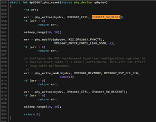

  • Hi Amy,
    Thank you for confirming, this is the issue. The DP83867 driver on our Github (linked below) does not set bit 15 of Reg 0x1F.
    However the driver available on Kernel.org has the reset as you describe it. The screenshots below are from the Kernel.org link.
    This is a very simply fix, only one variable needs to be changed! Please find the description below.
    1. Confirm the driver you are using has both of these Macros declared: DP83867_SW_RESET & DP83867_SW_RESTART
    2. In the phy_reset function, change DP83867_SW_RESET to DP83867_SW_RESTART
    3. Make sure rebuild the file before testing
    Alvaro
  • Hi Alvaro,
    Thank you for following up.
    I traced the log of `dp83867.c` on Kernel.org and found that the commit "net: phy: dp83867: perform soft reset and retain established link" link introduced the use of `"DP83867_SW_RESTART"`. However, the subsequent commit "Revert 'net: phy: dp83867: perform soft reset and retain established link" link rolled back to `"DP83867_SW_RESET"`, resulting in a full reset, including registers.
    Our customer prefers not to hard-code or rebuild the driver as a workaround for this issue. Based on your description, performing "DP83867_SW_RESET" may not be the correct action here. The best solution, in this case, would be for TI to upstream an updated driver to Kernel.org. Could you let me know if this is feasible? Thanks!
