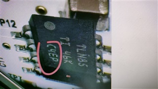

Hi TI team:
Could you help to provide the marking rules and meaning for TLIN10285DRQ1 part?
As below picture, we want to know the meaning with line 1&2&3 of the marking? thanks.
  • Hi Carol,
    It is the assembly lot code. See below, thanks.
         +-------------+            TI = TI LETTERS
         !   TLN85   !            YM = YEAR MONTH DATE CODE
         !   TI YMS  !             S = ASSEMBLY SITE
         !   LLLL      !          LLLL = ASSEMBLY LOT CODE
         !_O______!
    Michael.
