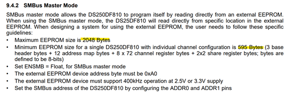

1: The  chip load from extern eeprom,how to deal with the pin en_smb(E3) and read_en_n(F13) ?both are pull down?

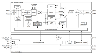

2: how is the crosspoint of DS250DF810 ,please supply a pciture

    1. Please see the "SMBus Master Mode" section of the data sheet and the pin descriptions for ENSMB and READ_EN_N.
      • EN_SMB -> Float
      • READ_EN_N -> Pull down
        • If you're using the same EEPROM for two devices, set READ_EN_N -> pull down on device 1.  For device 2, cascade ALL_DONE_N from device 1 to READ_EN_N of device 2.
    2. I don't understand your question.  Can you please clarify?  Please see the block diagram and section on "Cross-Point Switch".

  • 1:After eeprom is loaded, The leve of the pin all_done_n(D3) is low ?
    2: what is the capacity of eeprom at least?
    Yes, this is correct.
    I'd recommend using either 1kByte or 2kByte EEPROM.
