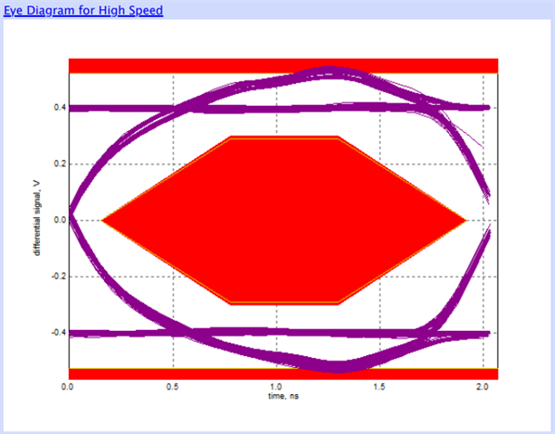

    3. I see you're also having issues with USB2 compliance. Looking at the eye diagram, there is excessive pre-emphasis on the signal that is violating the upper and lower bounds:
    I recommend lowering your host pre-emphasis/overshoot to pass compliance.
    Shane

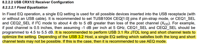

    Fixed Equalization for CRX1/2, USB3.1 is recommended with fixed EQ and USB 3.2 is recommended AEQ mode.
    My system is for USB3.2, so I guess that AEQ mode is better based on datasheet.
    Current situation USB3.2 compliance test didn't pass.
    Are there advantages and disadvantages to enable/disable(fixed EQ) for AEQ?
    ttd
  • Hi ttd,
    Using Fixed/AEQ does not depend on the USB spec version you're using (3.1 or 3.2). From the standpoint of EQ, there is no difference between these two protocol standards.
    Fixed EQ means you're using a set EQ value for any channel connected to the type-A receptacle, regardless of the actual channel length. The drawback is that this EQ value is often not the best setting for any connection that is made, as it needs to compromise between short cables and long cables. AEQ fixes this by dynamically setting the EQ value based on the connection on the Type-A receptacle.
    I recommend using AEQ to give your system the best chance at passing RX JTOL.
    Shane

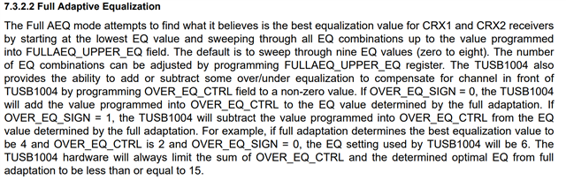

    By the way, according to the datasheet "Full Adaptive Equalization" , there are some combination of register setting.
    Can you tell me if there are any common combinations to try for starters?Defatul settings are better?
    I also confirm when are additional add and sub necessary with OVER_EQ_SIGN  and OVER_EQ_CTRL?
    FULLAEQ_UPPER_EQ =8h(AEQCFG="F")
    OVER_EQ_SIGN = 0h(positive)
    OVER_EQ_CTRL=0h(0 or -8) ← no  addition for EQ value of AEQ
     I don't understand follwing description especially. Does "in front of TUSB1004" mean yellow circle on block diagram?
    ーーーーーーーーーーー
    The TUSB1004 also provides the ability to add or subtract some over/under equalization to compensate for channel in front of TUSB1004 by programming OVER_EQ_CTRL field to a non-zero value.
    ーーーーーーーーーーー
    ttd
  • Hi ttd,

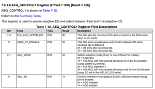

    - Set the CTLSEL and USB_MODE registers to enable USB
    - Set register 0x1C to F3
    This is only necessary if you want to tune the AEQ higher or lower. I recommend keeping these registers at their default values to start.
    Yes that is correct.

    I'm going to try to set 0x1C to F3. It means FULLAEQ_UPPER_EQ= Fh for sweep EQ wider range than 8h(default).
    I think that it have a chance to adjust the appropriate EQ setting. Is that extend time for polling retry test? (TD 7.40 Fail?)

  • Hi ttd,
    Changing the FULLAEQ_UPPER_EQ register should not affect the time in your polling retry test.

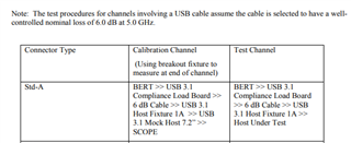

    AEQ settings for TUSB1004, I assume that the Long Channel test is for long cables and the Short Channel test is for short cables(like USB memory), is this correct?
    If so, what is the specific length of the long/short cable?
    In general complicance test doc, it seems to be 3m cable + long host PCB for long channel and short channel means (No cable + short) host PCB.
    ttd
  • Hi ttd,
    Yes this is correct.
    The long/short channel tests are not based on length, they are based on loss between the signal source (typically a BERT for compliance) and the USB-A receptacle. The loss comes from a set compliance channel that is typically a combination of fixtures and a USB cable. You can see the test channel used in a standard Type-A long channel compliance test at this resource.
    Short channel only uses a breakout fixture like you mentioned.
    Shane
