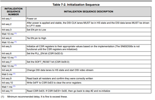

Is it important that the driver of the SN65DSI84 is initialised after the display driver or rather the other way round?
Or does it make a difference?

Its best to initialize the SN65DSI84 before any data is sent to the pins. Its best to initialize the driver, and hold the data lanes in LP11 state.
Please refer to the initialization sequence of the device.
