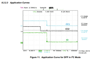

    Our CC controller does not support the PD protocol. A CC controller is a simpler device and the CC negotiation will differ from a PD controller. In the TUSB322I datasheet, you can see that the unused CC line is expected to drop to nearly 0V after attachment:

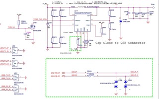

    It sounds like the current is being limited to 500mA somewhere in your power circuitry. If you are able to provide the schematic I can take a look as well.

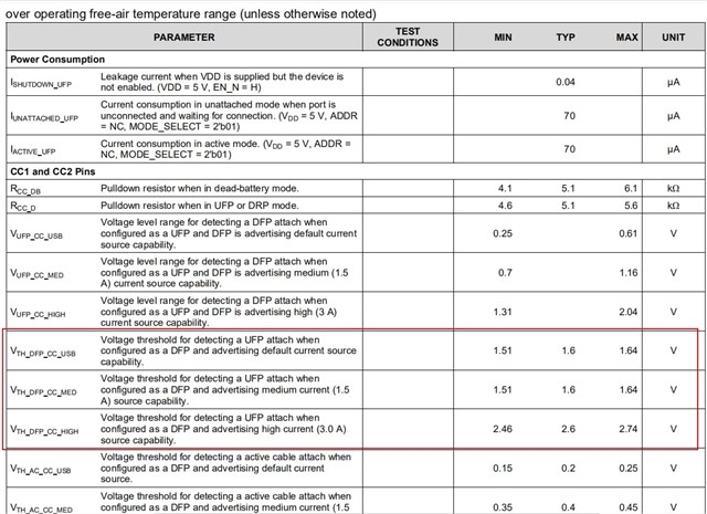

  • TUSB322 When using the CC pins to negotiate the operating current externally when acting as a DFP, the voltage on the CC pins are specified as follows. This voltage threshold standard is not the same as the PD contract standard, Do you think this is root cause?

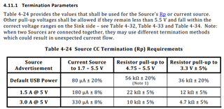

    The thresholds you have circled are not the voltage thresholds on the CC lines. These are the voltage thresholds that the internal current source is pulling from when advertising DFP mode. The actual CC voltage detection levels will align with the USB C spec:
    1.67V is well within the margin of error for 3A advertisement. Going by the USB-C spec, the nominal 3A advertisement CC voltage would be 330uA * 5.1Kohms = 1.683V.
    This means we are correctly advertising the current as 3A. There seems to be an issue with the mobile phone recognizing this. I believe the phones/tablets do not support a 5V/3A VBUS without a PD contract being negotiated. This is not something we can fix as our CC controllers do not support the PD spec, we only support the type-C functional test spec.
