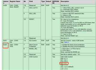

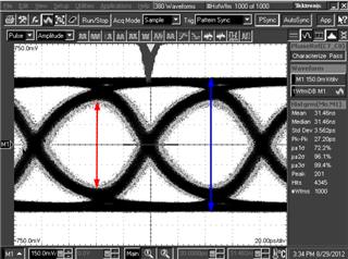

  • hello  1. Debug VOD according to the register in the picture and observe the TX amplitude in the eye diagram. No significant changes were found. May I ask if I want to debug VOD directly by debugging this register in the picture

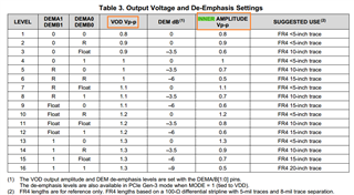

    What is the difference between VOD Vp-p and INNER Vp-p for the two selected parameters in the following picture
  • Hi Evan,
    The red arrow shows inner amplitude, also known as eye height. The blue arrow shows VOD or outer amplitude. As you can see in Table 3, higher de-emphasis setting results in smaller inner amplitude.
    Note that you will not observe these exact VOD and inner amplitude values when the device is configured in 10G-KR mode. 10G-KR mode changes the signal chain to maintain linearity, meaning the output ampitude will track the input amplitude more closely.

  • Hi Evan,
    1. If you are writing register 0x2D bits 2:0 to modify the VOD setting on channel A0 only, then your register configuration is correct.
    2. Yes that's correct, changing VOD setting is not expected to cause a significant change in 10G-KR mode.
    3. In any operational mode, VOD setting is not expected to have much impact on eye opening. This is because VOD controls the outer amplitude. CTLE is the primary setting to improve eye opening, and DEM can assist as well. Please refer to my explanations of these settings above.
