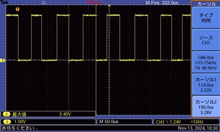

    Are you able to write to the AFR register and set the BAUDOUT bit? (AFRb1=1)
    Then probe the MF1/MF2 pins. If you write to the DLL/DLM registers you should see the Baudout pin change to become 16x of the baudrate. We can try to use this to verify if the registers are being written to (incase we can't read them correctly).

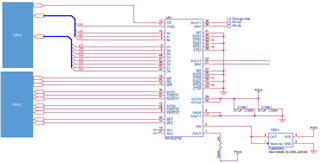

    Are you also able to share your schematic for the NS16C2752?

  • >Are you able to write to the AFR register and set the BAUDOUT bit? (AFRb1=1)
    step1:AFR=0x02
    step2:READ DLL/DLM
    step3:DLM=0x00
    step4:DLL=0x02
    step5:READ DLL/DLM
    Comparing after step 1 and after step 4, there was no change in the output of MF2.
    The DLL/DLM values obtained in steps 2 and 5 are DLL=0xDE and DLM=0x01.
    The output of MF2 was captured and is attached.
    Attached is a schematic diagram of the NS16C2752 peripheral.
    Please point out any incorrect connections.
    Read/write is executed from CPU1 and interrupt monitoring is executed from CPU2.
  • I don't see any big concerns with the schematic and it seems like you have local decoupling on Vcc.

    Thanks for checking this. It seems that there are values in the registers but the steps provided aren't toggling them at all. The only other thing I can think of is to probe all the input pins during each step to verify the pins are actually set to what we expect. Maybe the other issue is the MR pin is somehow getting reset before we try to write to DLL/DLM...
