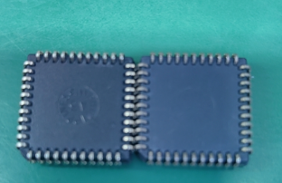

PART# TL16C550CFNR
D/C: 2434
The pin color seems darker than previous samples.
Below comparison photo for your reference, (left side: sample; right side: this batch)
Have you changed part material or something? Thanks.

Hi Luhia,
Yes, we've sent a PCN (attached) for this device. Essentially there was a die change for the device.
TL16C550C PCN20210413000.1.pdf
I would probably need to see the top markings to verify which one is the old die vs which one is the new die based on the second line's date code.
