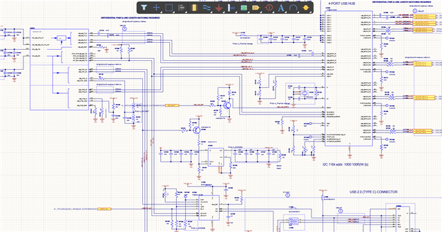

 I attached snip of Schematic  for your referecne.
I verified, R1443 value and it connection going to ADR Pin on board responding on 0X47 I2C address.
It is As per OK board. Also On Multimeter ADR Pin sees 3.3VDC as Pull up.
Also R1446 is Not FIt on Board on board responding on 0X47 I2C address.

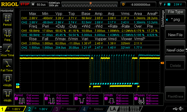

I attached I2C clk and data waveform  board responding on 0X47 I2C address and board responding on 0X47 I2C address. I don’t see any corruption on these waveform.
